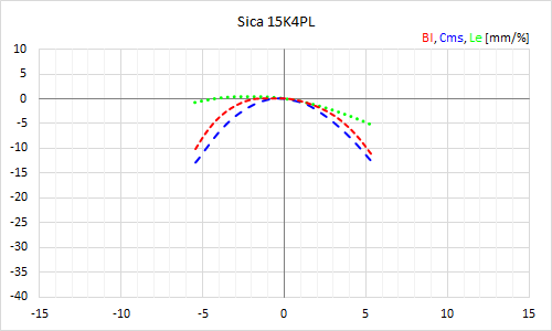

Sica 15K4PL
https://i.postimg.cc/YC7WWnst/15K4PL.png http://s10.postimg.cc/aycz1cwv9/asdfx.jpg
zdroj: starší pdf

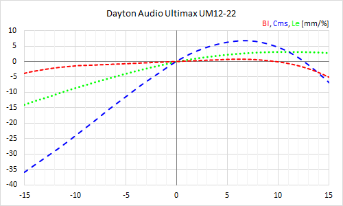

Dayton Audio Ultimax UM12-22
https://i.postimg.cc/bw46bBfg/UM12-22.png http://s10.postimg.cc/vstwwxgmd/um12_22.jpg
zdroj: Voice Coil 6/2013
https://www.yumpu.com/en/document/view/ … yton-audio

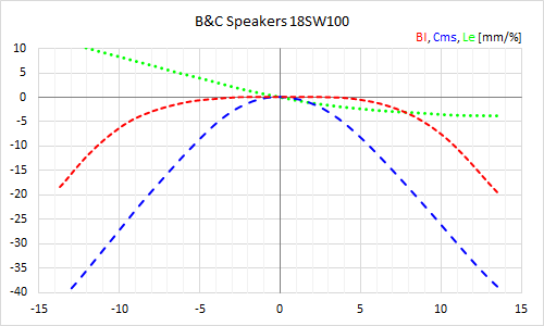

B&C Speakers 18SW100
https://i.postimg.cc/Z0kQpZvs/18SW100.png http://s4.postimg.cc/tswtgjbjd/18sw100.jpg
zdroj: Voice Coil 10/2010

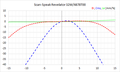

Scan-Speak Revelator 32W/4878T00
https://i.postimg.cc/N071MJs5/32-W-4878-T00.png http://s4.postimg.cc/w55qgvm09/32w_4878t00.jpg
zdroj: Voice Coil 9/2016
https://audioxpress.com/article/test-be … -subwoofer

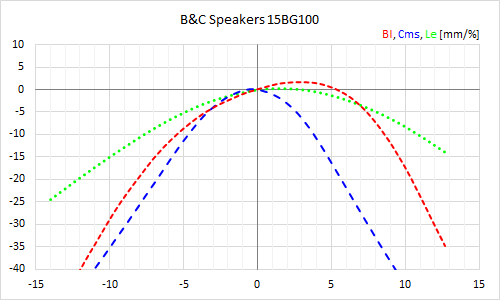

B&C Speakers 15BG100
https://i.postimg.cc/zX6hwvBG/15BG100.png http://s4.postimg.cc/vxj2anlex/15bg100.jpg
zdroj: Voice Coil 7/2010

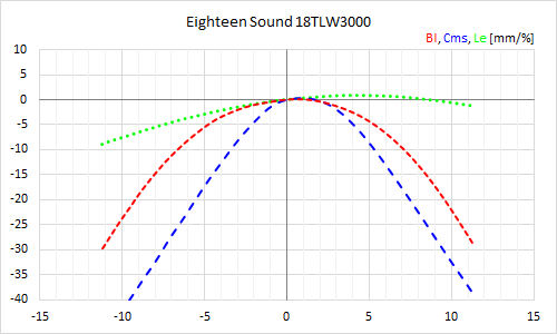

Eighteen Sound 18TLW3000
https://i.postimg.cc/pr9BTtTx/18-TLW3000.png http://s4.postimg.cc/k9bou992h/18tlw3000.jpg
zdroj: Voice Coil 12/2013
https://audioxpress.com/article/Test-Be … oil-Woofer
