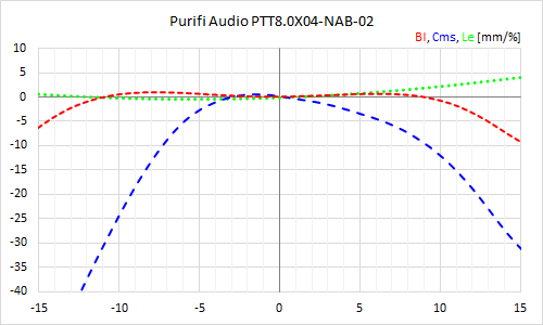

Re: Měření Klippel - chování při velkých signálech
Purifi Audio PTT8.0X04-NAB-02
https://i.postimg.cc/TYJQFCHZ/ptt80x04nab02.png https://i.postimg.cc/0b37GM2q/ptt80x04nab02.jpg
zdroj: Voice Coil 12/2023
https://audioxpress.com/article/test-be … one-woofer

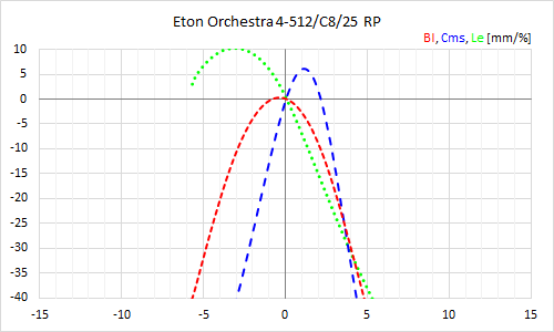

Eton Orchestra 4-512/C8/25 RP
https://i.postimg.cc/K8TvrMrL/4-512-c8-25-rp.png https://i.postimg.cc/pX4LFZ8R/4-512-c8-25-rp.jpg
zdroj: Voice Coil 8/2020
https://audioxpress.com/article/test-be … s-midrange

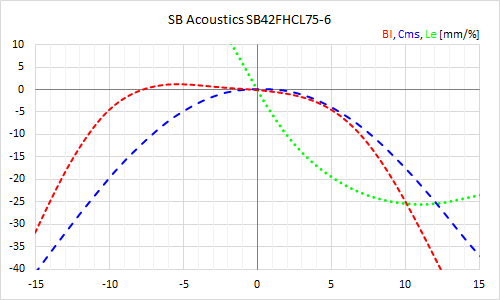

SB Acoustics SB42FHCL75-6
https://i.postimg.cc/3w2mznvB/SB42-FHCL75-6.png https://i.postimg.cc/Z5G6f1Cn/SB42-FHCL75-6.jpg
zdroj: Voice Coil 4/2016
https://audioxpress.com/article/test-be … -acoustics

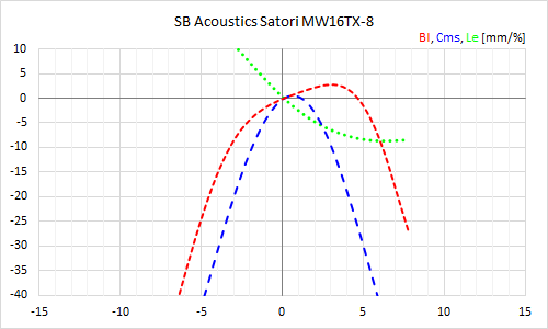

SB Acoustics Satori MW16TX-8
https://i.postimg.cc/6qXQfRKq/mw16tx-8.png https://i.postimg.cc/fR2JQJcq/mw16tx-8.jpg
zdroj: Voice Coil 6/2021
https://audioxpress.com/article/test-be … eme-woofer

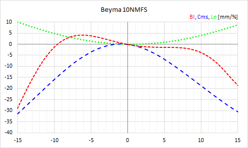

Beyma 10NMFS
https://i.postimg.cc/zfDxP2V6/10nmfs.png https://i.postimg.cc/5y85t8X8/10nmfs.jpg
zdroj: Voice Coil 8/2023
https://audioxpress.com/article/voice-c … d-nmf-line

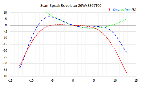

Scan-Speak Revelator 26W/8867T00
https://i.postimg.cc/rpwQ9MV7/26w-8867t00.png https://i.postimg.cc/523sv6Vw/26w-8867t00.jpg
zdroj: https://web.archive.org/web/20160702081 … -26w8867t/

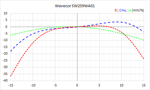

Wavecor SW259WA01
https://i.postimg.cc/ZKGNkQR0/sw259wa01.png https://i.postimg.cc/YSkm0mQH/sw259wa01.jpg
zdroj: Voice Coil 2/2023
https://audioxpress.com/article/voice-c … -subwoofer

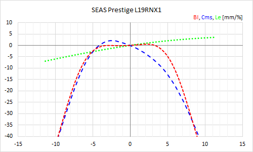

SEAS Prestige L19RNX1
https://i.postimg.cc/7ZxHBLbP/l19rnx1.png https://i.postimg.cc/t40RF5G6/l19rnx1.jpg
https://audioxpress.com/article/test-be … ies-woofer

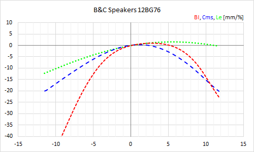

B&C Speakers 12BG76
https://i.postimg.cc/NG8D4j8B/12bg76.png https://i.postimg.cc/X7V8D6xF/12bg76.jpg
zdroj: Voice Coil 10/2018
https://audioxpress.com/article/test-be … c-speakers
To je tedy zajímavé, že je u 12BG76 měřené v 2018 cca 5x lepší linearita závěsu oproti 15BG100 měřené 2010. Volaké dajaké čudné súdruzi.
Je to tak, jsou to kolikrát divná data a už dřív jsem to chtěl vzdát - Vance neviděl problém s tímto, tak co si o tom myslet...
(upravil check 9. 7. 2024 10:07)
Je to setup za 15000 € a stejně neumějí nastavit osy nebo vyexportovat správně data. Za mě to jsou nedůvěryhodné výsledky. Jak by bylo těžký udělat DIY Klippela? How hard can it be?

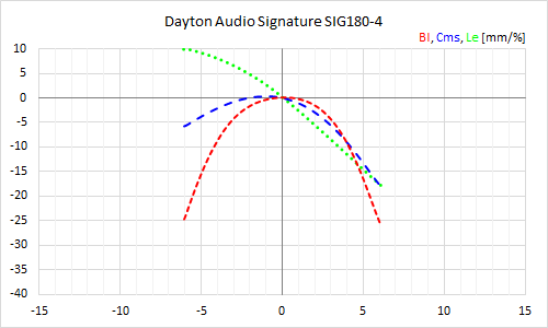

Dayton Audio Signature SIG180-4
https://i.postimg.cc/L6g3XHKg/sig180-4.png https://i.postimg.cc/JzwcH9M6/sig180-4.jpg
zdroj: Voice Coil 3/2024
https://audioxpress.com/article/test-be … ure-series
