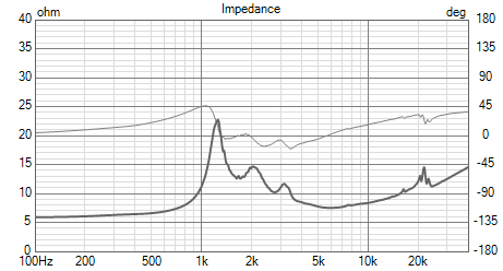

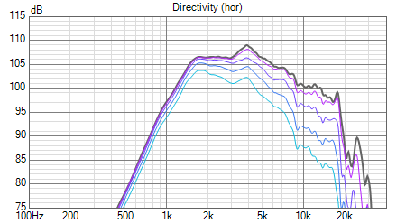

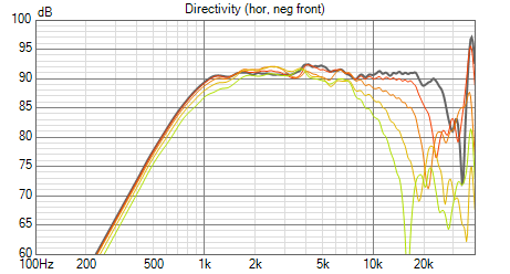

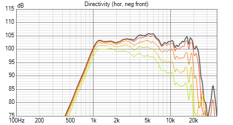

Re: Tonyho měření 2 - výšky a drivery
SICA LP98.25/245TW
https://i.postimg.cc/Y0qG0jkx/shot001.png https://i.postimg.cc/qqbt30vH/shot002.png
https://i.postimg.cc/RCXJ81Qp/shot003.png https://i.postimg.cc/WbzqPD5N/shot004.png

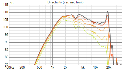

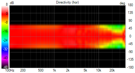

Lavoce DN10.172K
https://i.postimg.cc/C1Z5D15S/shot001.png https://i.postimg.cc/Y9J9xHLg/shot002.png
https://i.postimg.cc/02GQ7hkM/shot003.png https://i.postimg.cc/GtGp75vf/shot007.png
vertikálně:

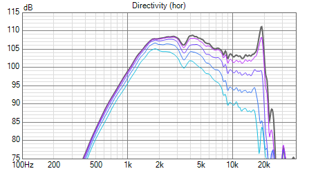

https://i.postimg.cc/ZYd05CXL/shot004.png https://i.postimg.cc/021jM9s1/shot005.png https://i.postimg.cc/x10d5g8s/shot006.png

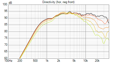

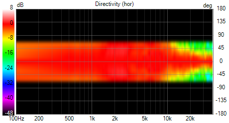

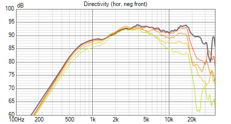

Bliesma T25B-6
https://i.postimg.cc/rwNyw8P6/shot001.png https://i.postimg.cc/438JpWGB/shot002.png
https://i.postimg.cc/TP2dyZzK/shot003.png https://i.postimg.cc/9fQMB8BM/shot004.png
