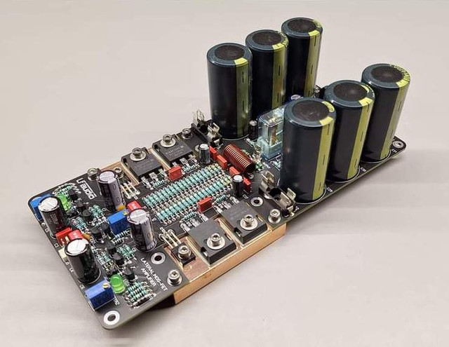

Lateral Mosfet 200W-4Ohm od LF Audio smile
https://i.ibb.co/Xtz4F68/lf-audio.jpg
neni to ale dpa...
