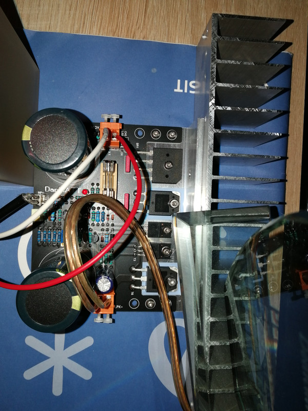

Danwatt ... - Benazi - 11. 9. 2020
Také mi to maká, sice jen na stole.
[Image: IMG-20200819-090525.jpg]
