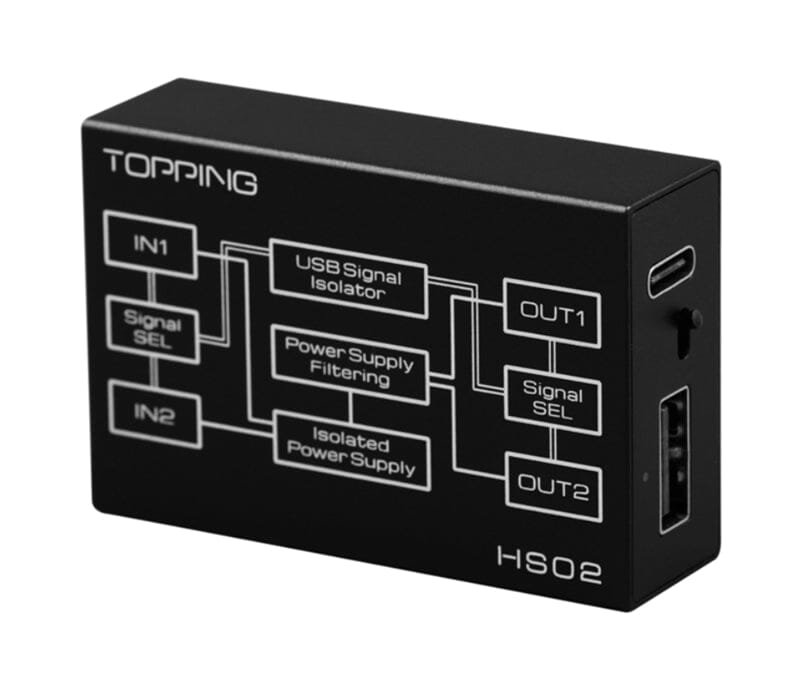

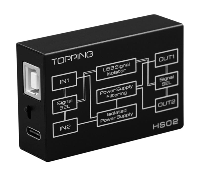

čínský z alíku (pomalej 12Mbps a rychlej 480Mbps s ext napájením) dva novější topping HS-02 a Texas Instrument USB ISO modul oba rychlé 480Mbps. Smile Bez toho ani ránu.

[Image: topping-hs02-usb20-high-performance-high...1675904336]
[Image: topping-hs02-usb20-high-performance-high...1675904328]
https://hifigo.com/products/topping-hs02
Citace: Miero napsal
A maju uz nejake cinske DACy galvanicky izolovany USB vstup?

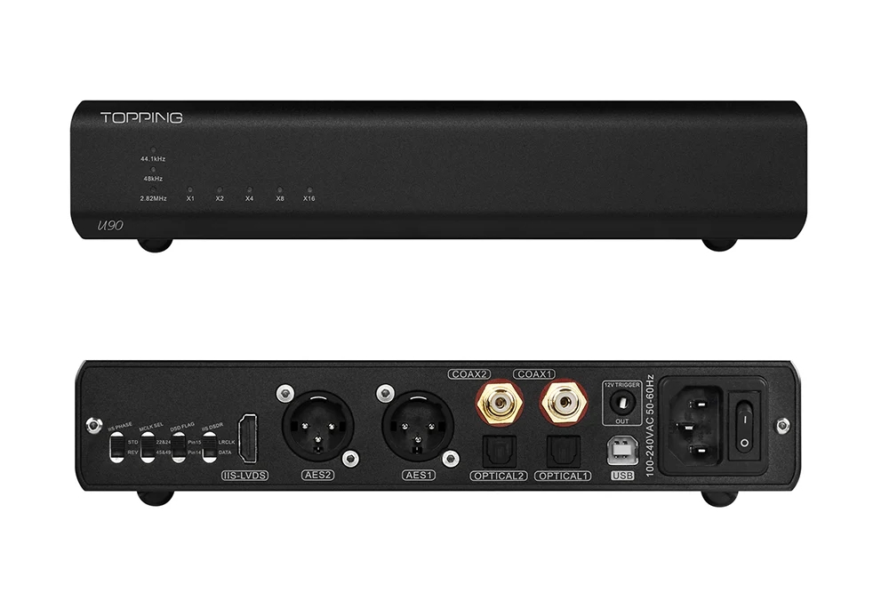

Mám Topping U90 USB Interface a to ho má
[Image: u90.jpg]
https://shenzhenaudio.com/products/topping-u90-usb-bridge-pcm768khz-32bit-native-dsd512-high-res-usb-interface-with-multiple-outputs?srsltid=AfmBOopT6M77pYjJPbLTD3aWjj_6e5NmPA7gTOsPFxYat24RZBZyixPm
