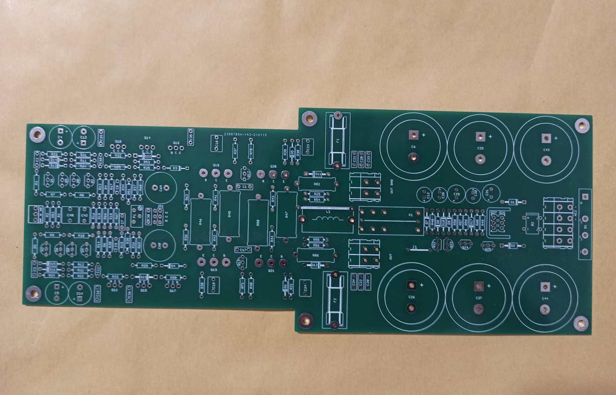

Leach od Tubamusic Smile 255x 100mm
[Image: leach-tuba.jpg]
